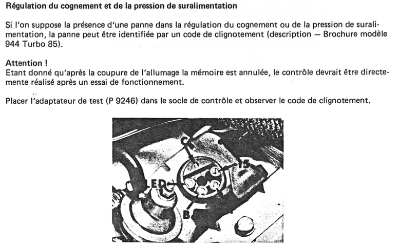

https://www.lindseyracing.com/LR/Parts/BLINKCODE.html
https://rennlist.com/forums/924-931-944-951-968-forum/91320-dme-light-diagnose-codes.html#post796480
Sur ces sites le listing complet des codes défaut en PDF.
http://members.rennlist.com/951_racerx/TestSocketBlinkCodes.html
http://www.arnnworx.com/catalog/index.php?main_page=product_info&products_id=292&language=fr#.WMJcXxBq_Ts

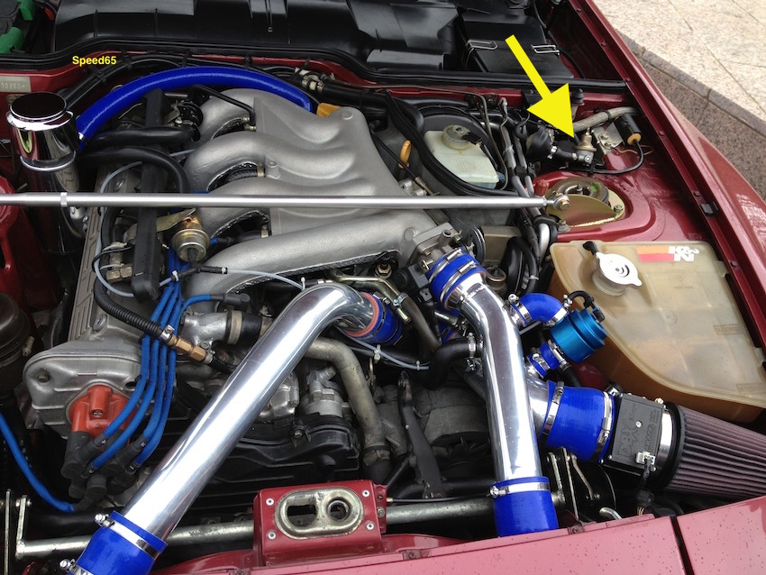

Il est bien caché, coté conducteur, à coté de la vanne de recyclage des vapeurs d'essence.
Cela permet de détecter des défauts.
Listed below are the codes | possible repair
1-2 voltage under 10.2 | check alternator, battery, regulator, relays or wiring
2-1 knock sensor | Engine damage, tappets rattle, faulty valve, rod bearing, engine knocks.
2-2 knock sensor | Sensor Installation, plug connection at sensor
2-3 KLR defective | Replace KLR
3-1 boost pressure low or zero | Bad wastegate, turbo or intercooler leaks.
3-2 boost pressure to high | Bad Wastegate, cycling valve, wastegate hose off.
3-3 pressure sensor in KLR defective | Replace KLR
4-1 throttle position sensor or wires | Power wire to TPS, ground contact or connection dirty.
4-2 throttle position sensor or wires | TPS bad, but check wires first.
Keep in mind, you could have low boost but not low enough to set off code 3-1. Another important note, manual states if you get code 4-1 & code 3-3 together, ignore 3-3. Lastly, you might want to verify all this by unplugging the TPS, drive around the block or running about 1500rpm, and see if it blinks code 4-1.
Doc Porsche, extrait.
